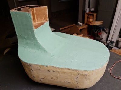

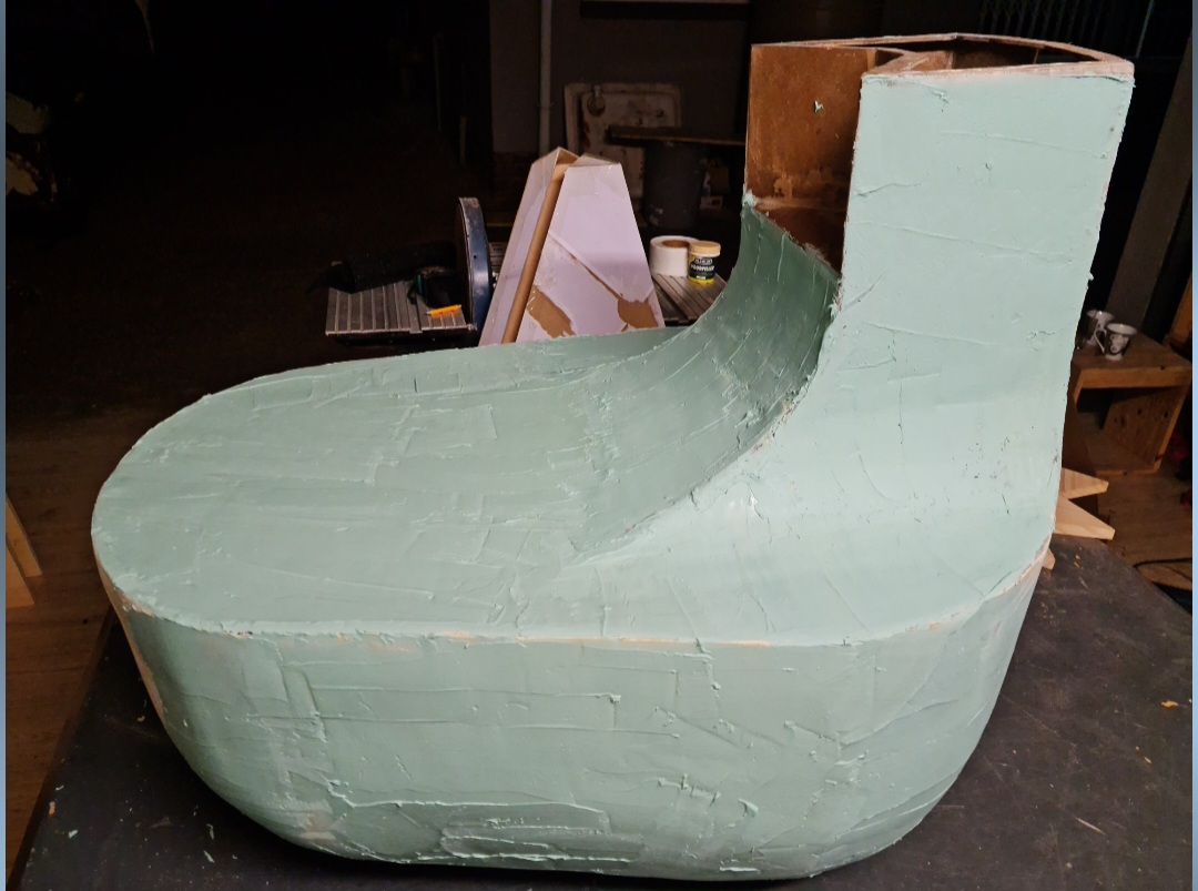

Hi all.
So been a busy day...
Decided to get new putty, different color as it was getting difficult to see where I have been working and still need to work... :lol:
So this should be close to the final layer except for some minor shaping on the rounded sections...
And tomorrow, More sanding... And more sanding... And more sanding... :lol:
But then hopefully soon after that I can finish the back section and the bottom gap then lay it down in primer... Then I will call it done for the interim...

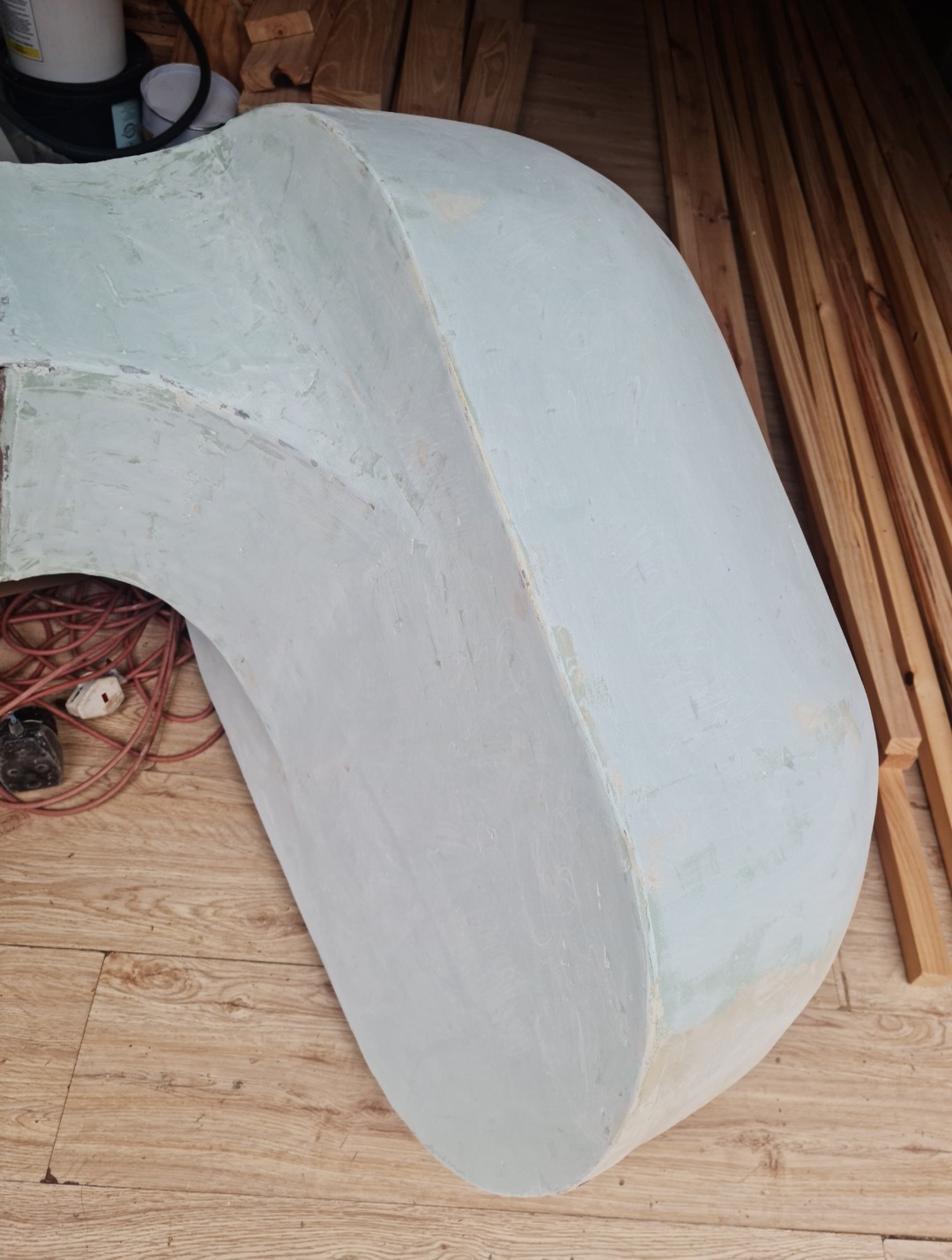

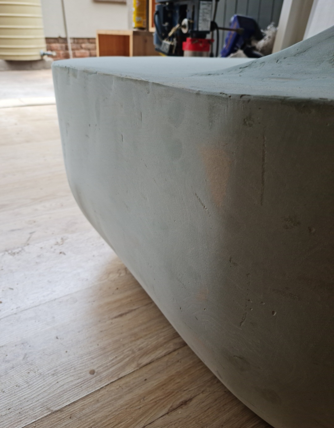

Ok so Im calling it a day for today...
Did plenty of sanding and the afterburner is basically in the final stages now before primer...
Still have a few small odd spots and sections to do touch ups on as well as the edges to be rounded slightly... But next weekend...
Started with 100 grit paper, then went to 220 grit...
Tried to get a nice clear shot of the side being nice and smooth but best I could do now...
Before I do primer, I will do one more run over with 400 grit paper...
The possibly do 2 or 3 coats of primer then I will run over it with 800 grit and move upward from there...

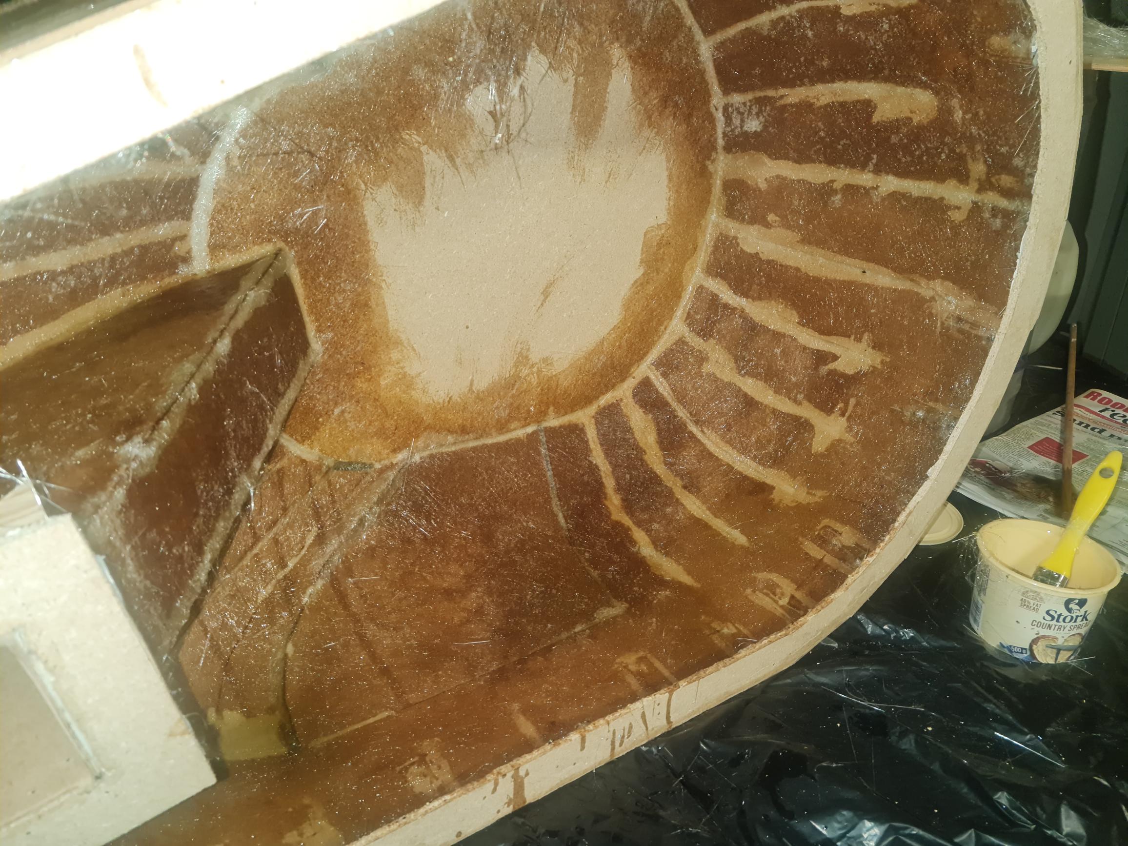

slysnake wrote: Tue Oct 17, 2023 5:22 pm Looks really good. I would be tempted to cover it with a layer of fiberglass for strength.
Hey Slysnake

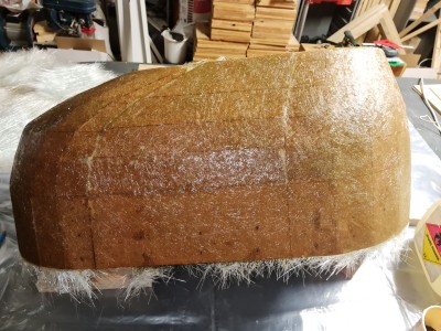

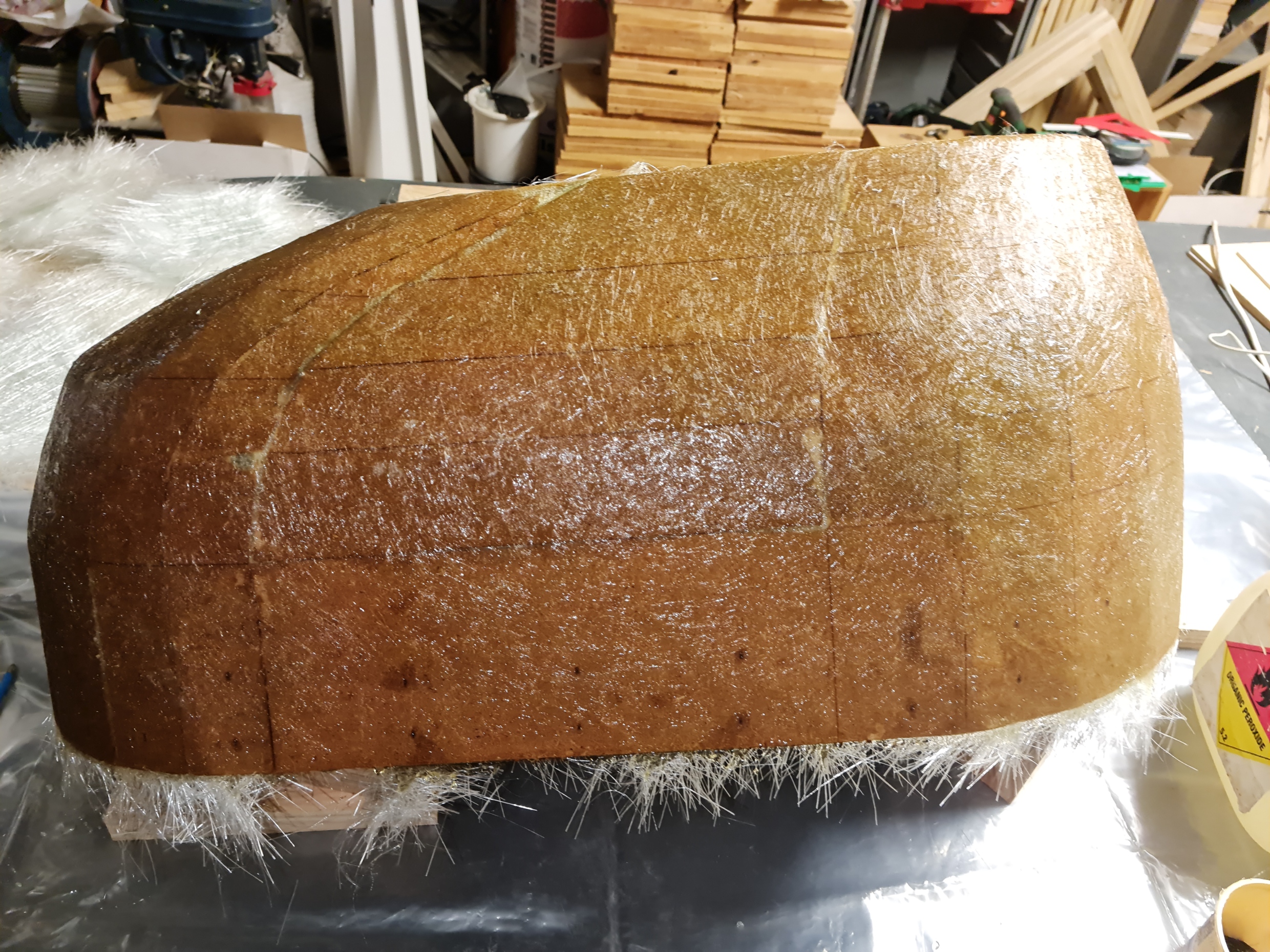

This unit is actually very strong at the momonet...
Remembering I did 2 layers of fiberglass inside to hold the shape and I did 2 layers outside...
And thats also after I did 2 layers of resin before the fiberglass matting...
Inside:
Outside
Although the only section I was thinking of adding another layer of fiberglass to was the top back section... As its got the opening at the back and the top slit section, I think I might add one extra layer there just to put my mind at ease...
But as for the rest of the unit, Im happy...
