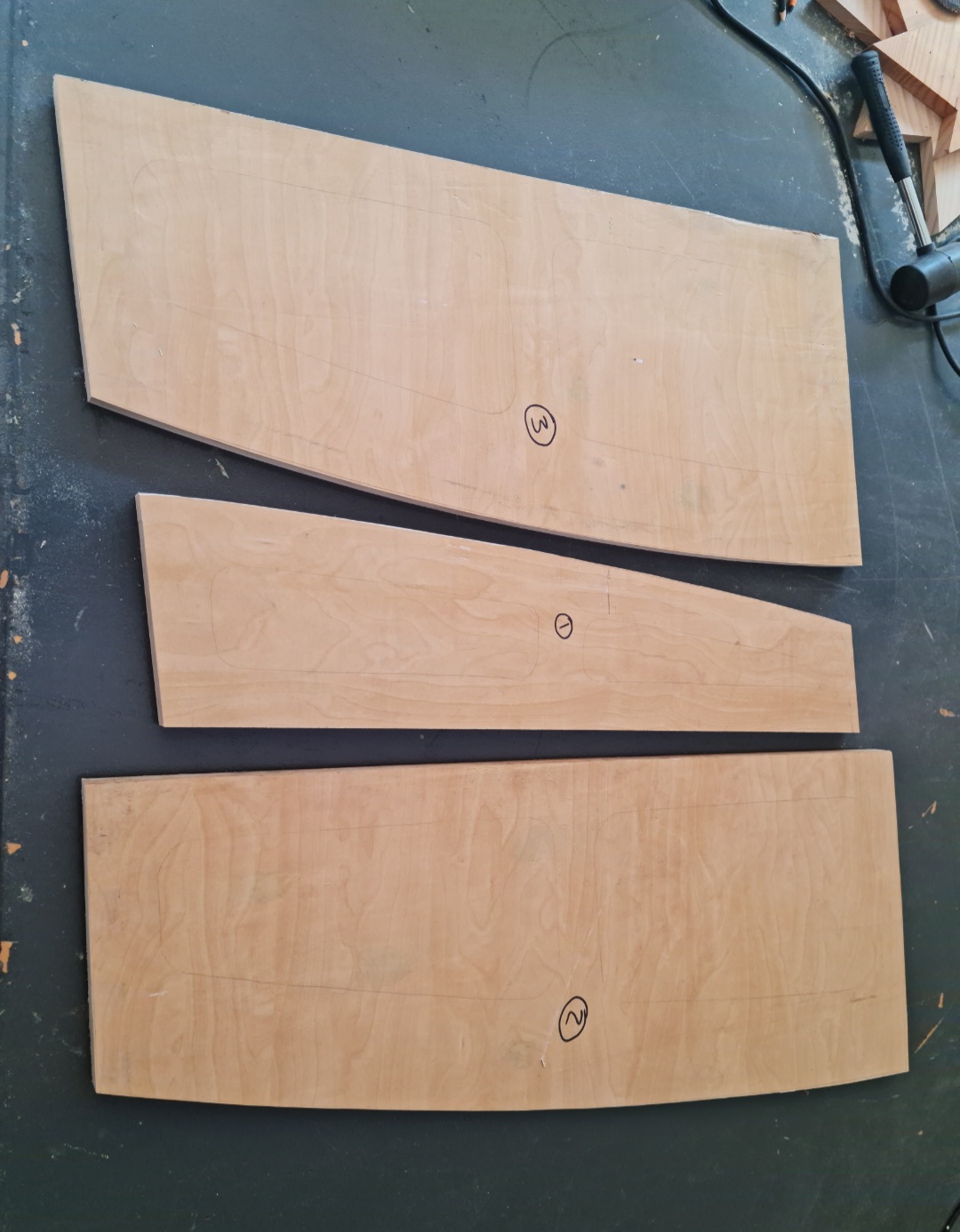

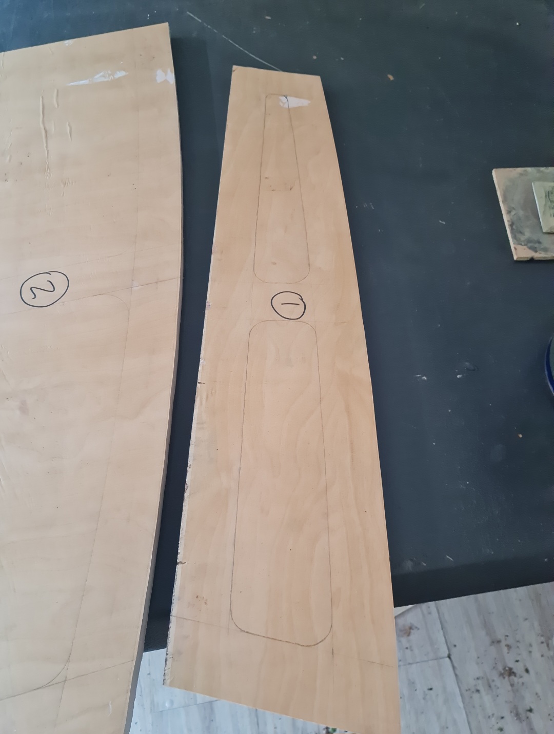

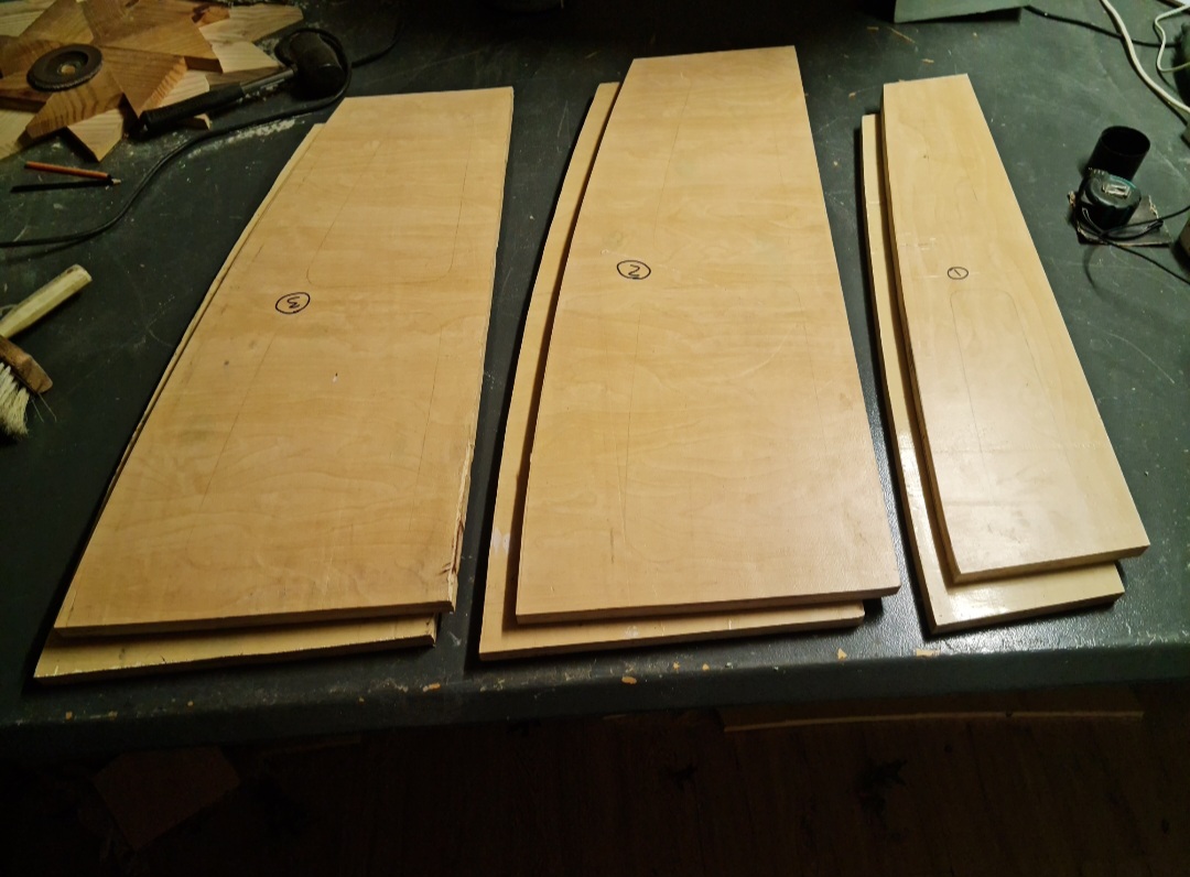

So now for the part of getting to the shape and reducing the weight...
So you will see that I marked out 2 inch borders around the edges and the plan is to cut out the center sections and fill them with a polyurethane based expanding foam.
But after looking at the pieces I cut for the side shapes I could see that fin number 2 and 3 were not going to work so well with 2 inch border as those edges would be too thin, so I made them 4 inches on the back end...
Set all ready.
Number 1 (Back most unit) is fine with the 2 inch frame as the shape will work well.
Units 2 and 3 will be too thin on the tips so hence the 4 inch gap on the tips...
Set all ready.

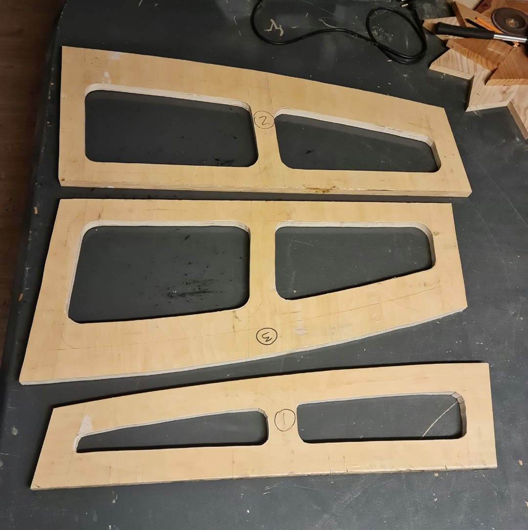

Update:
Ok so last night & today was spent cutting...
First had to cut out the second set of the flaps... And sand as the first set...
Front edges were not fully flushed on the line as I was thinking of using the edges to mount tail lights (LED strips) and Indicators on...
And besides that I need to shape them down anyway...

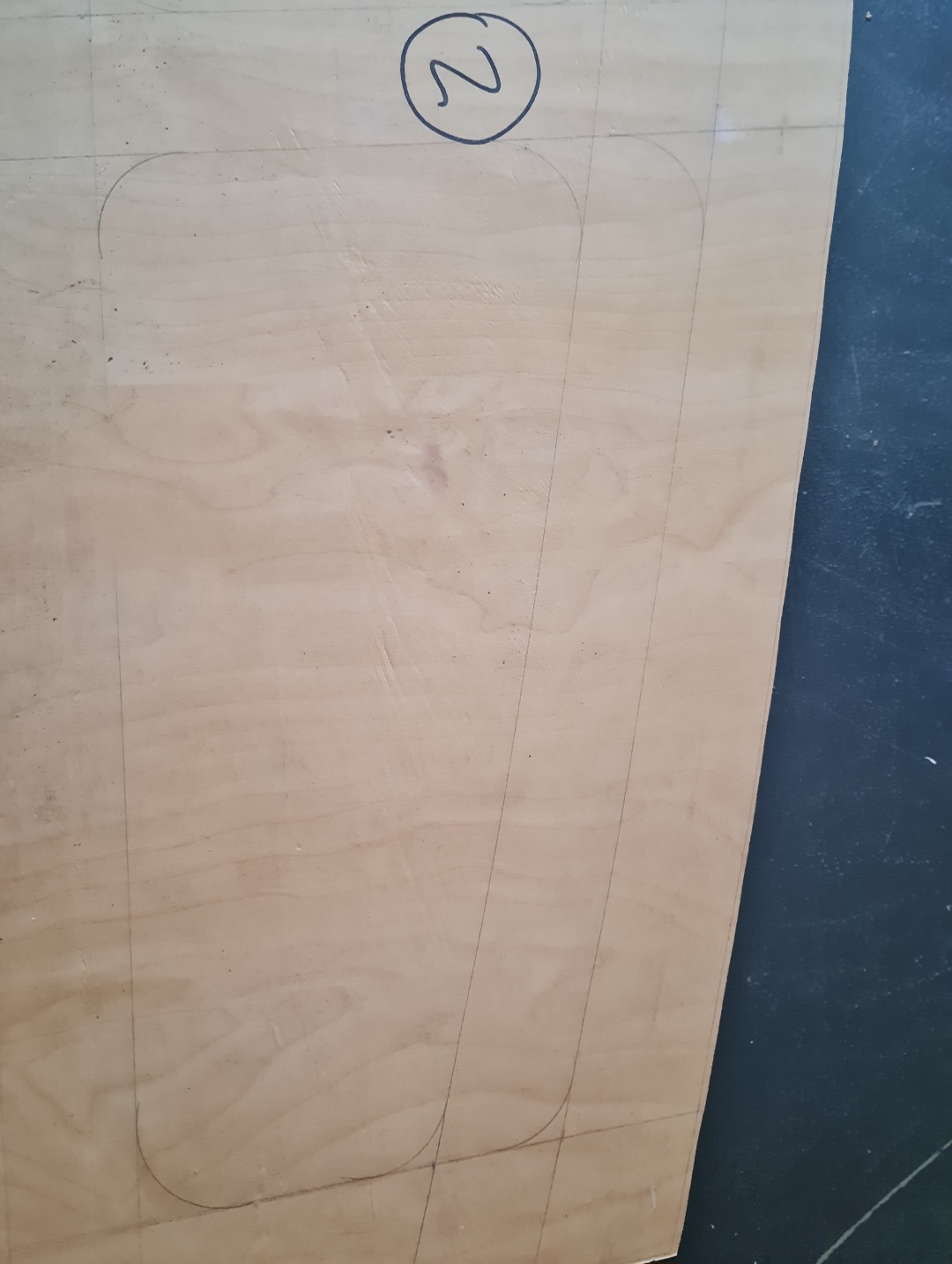

- Posts: 149
Re: ** WAR's Black Tank **

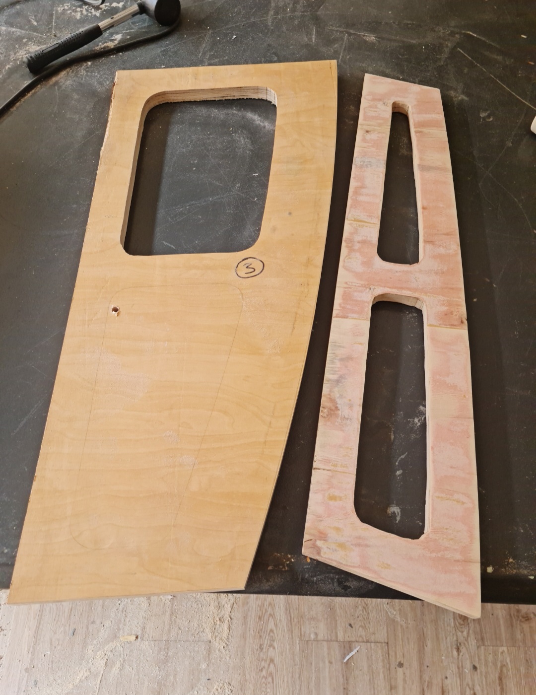

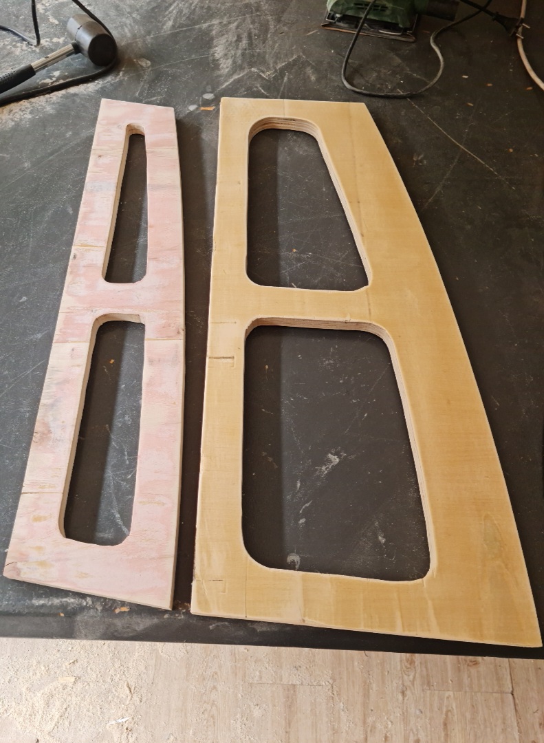

Then:
I started cutting out all the center sections...
All I did with the middle brace section was measure the halfway mark, add 1 inch on both sides and that made my 2 inch (5cm) middle section.
Then finished both sets...
And then I was double checking that I had enough 'meat' left on the edge for when I need to shape...
Using the side sections as my markers...
(Top line is 2 inches, Bottom line is 4 inches from the top...) So on these flaps (no 2 and no 3) the 4 inch looks like I will have enough on there to shape as needed...
(But still thinking about using those edges for the LED strips... But will see...

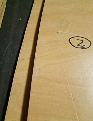

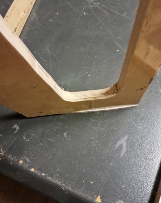

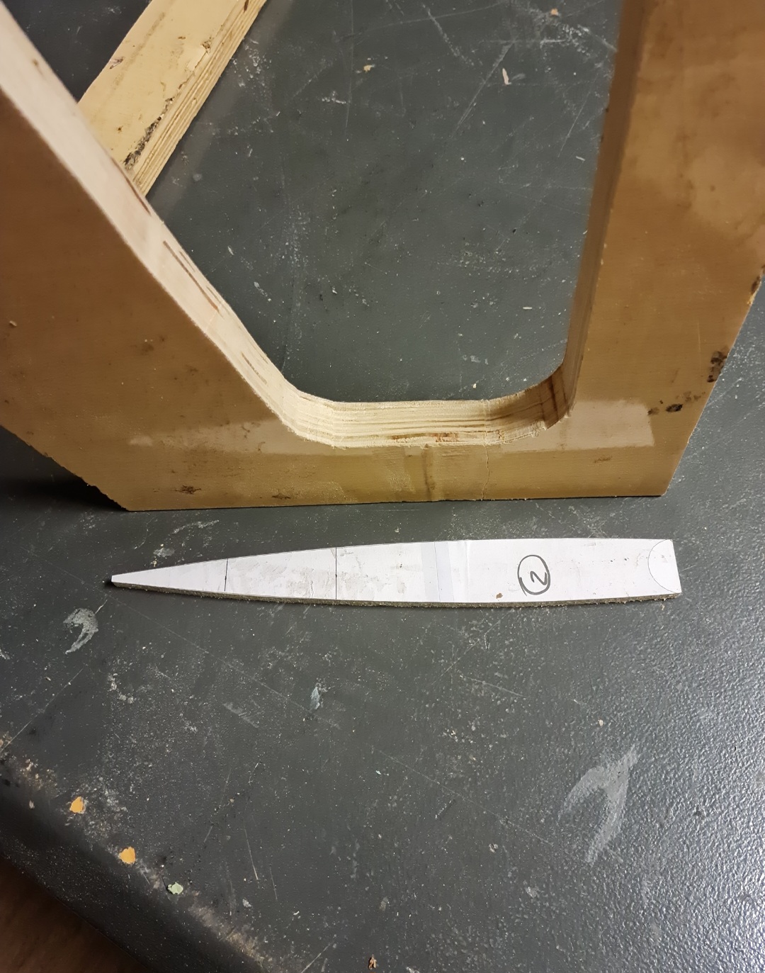

- Posts: 149

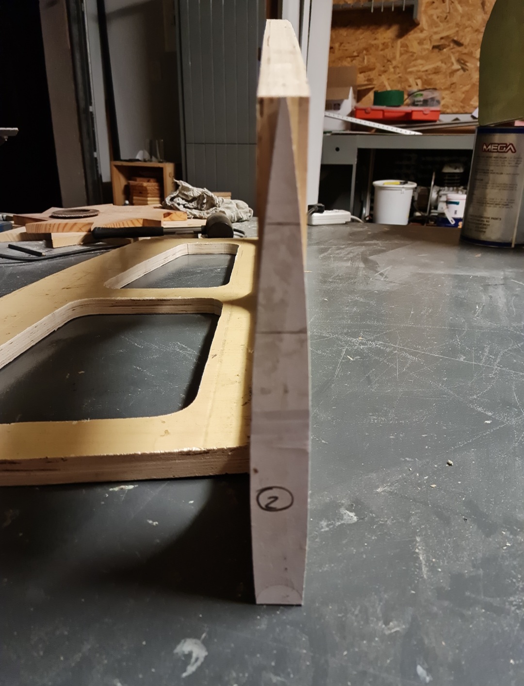

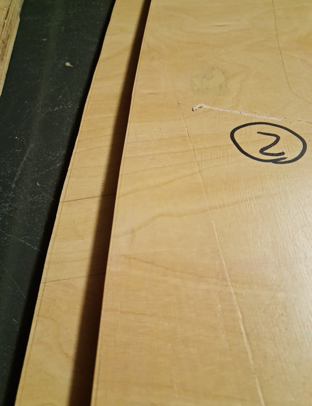

Here you can see using those cut outs that I dont have much to build up...
The board is 21mm thick and the side templates are:
Long Side is 35mm thick
Short Side is 28mm thick (As per pic below)
Can see here that the short sides dont need all that much filling or building up...

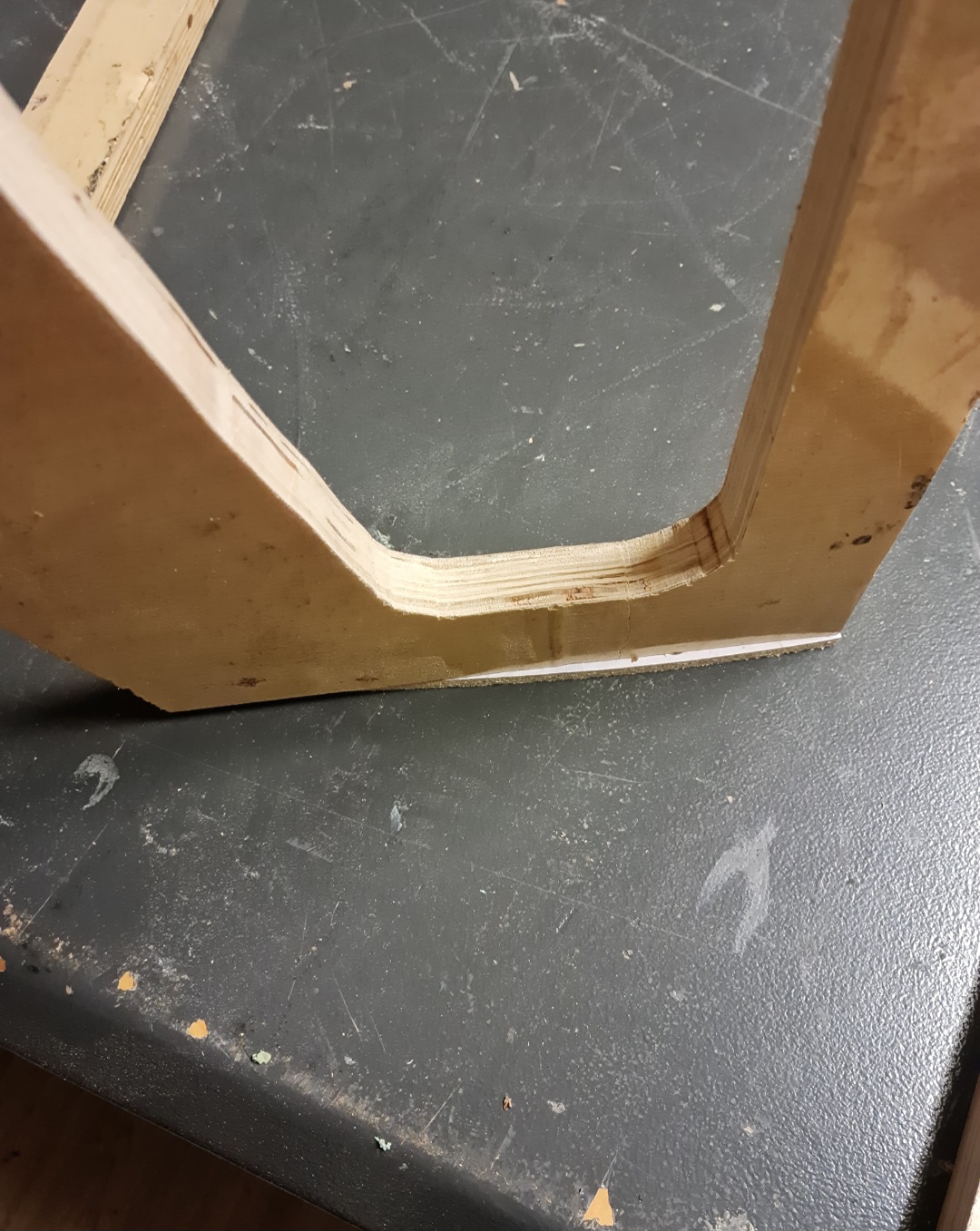

Then spent the rest of the day sanding and cleaning...
The board I used seamed to have a paper like thin layer on the one side of the board and the other side was a glossy surface...
So to make sure that I dont have issues down the line, I sanded both sides off on each flap / wing...
And as you can guess that was quite a while...
* Here you can see the left side sanded off and the right side still to be sanded...
Never saw this when I got the boards as I was just too happy to get the boards ...
(Well lesson learnt)
