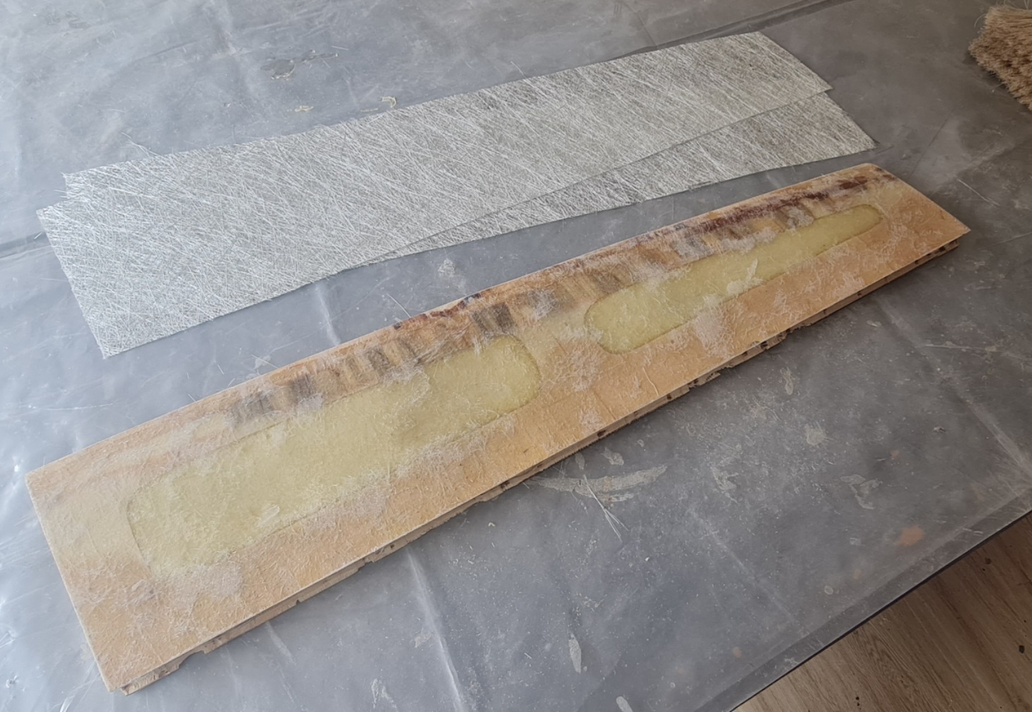

Ok so update...
After I cleaned up the new foam sections and cut the fiberglass for all the wings.

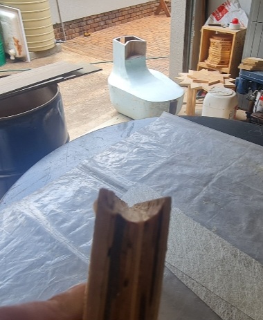

I spent some time with the router table and looking for a bit to shape out the back end sections of the wings that I need to mount the pipe section into...
So I did not have one big enough to run them thru once so I improvised and had to run them thru 3 times...
Basically, Once for the left section, then adjust and move to the right section, then adjust up and do a run in the middle...
And it worked... Although you can see its not a perfect radius, it will do...

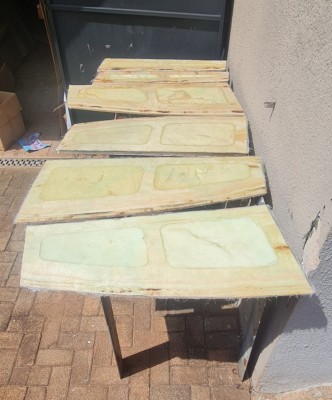

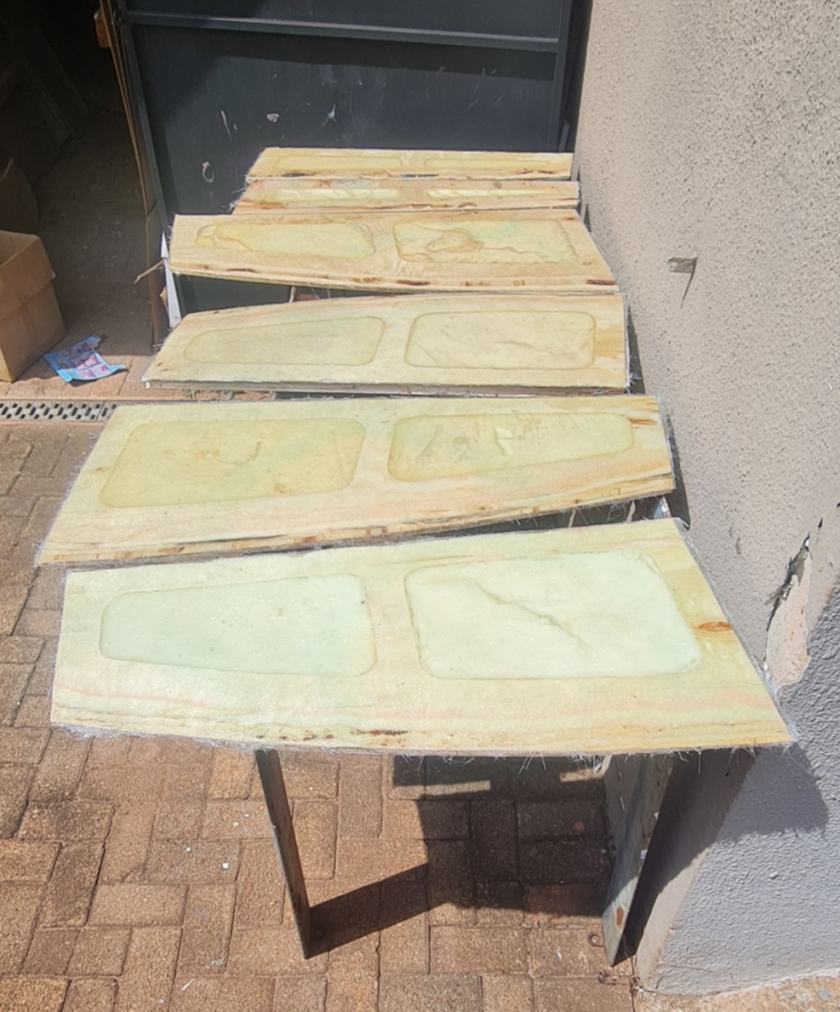

Then started to fiberglass the other side's 2 layers...
And then all done...
Now to leave them to dry...
And with cutting them to size, you can see there is almost no excess hanging over the edges to clean up...
Although thinking about it now, If anyone wants to do it this way, I would say there is no need to do the foam sections in them.
They are light enough in just the solid wood form and the foam method basically just wasted a bit of time and money...
But lesson learned and noted... :D
