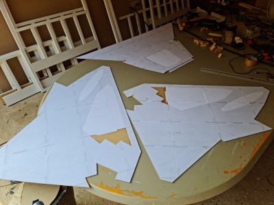

So I started getting the pieces sorted for the front nose cone... :D

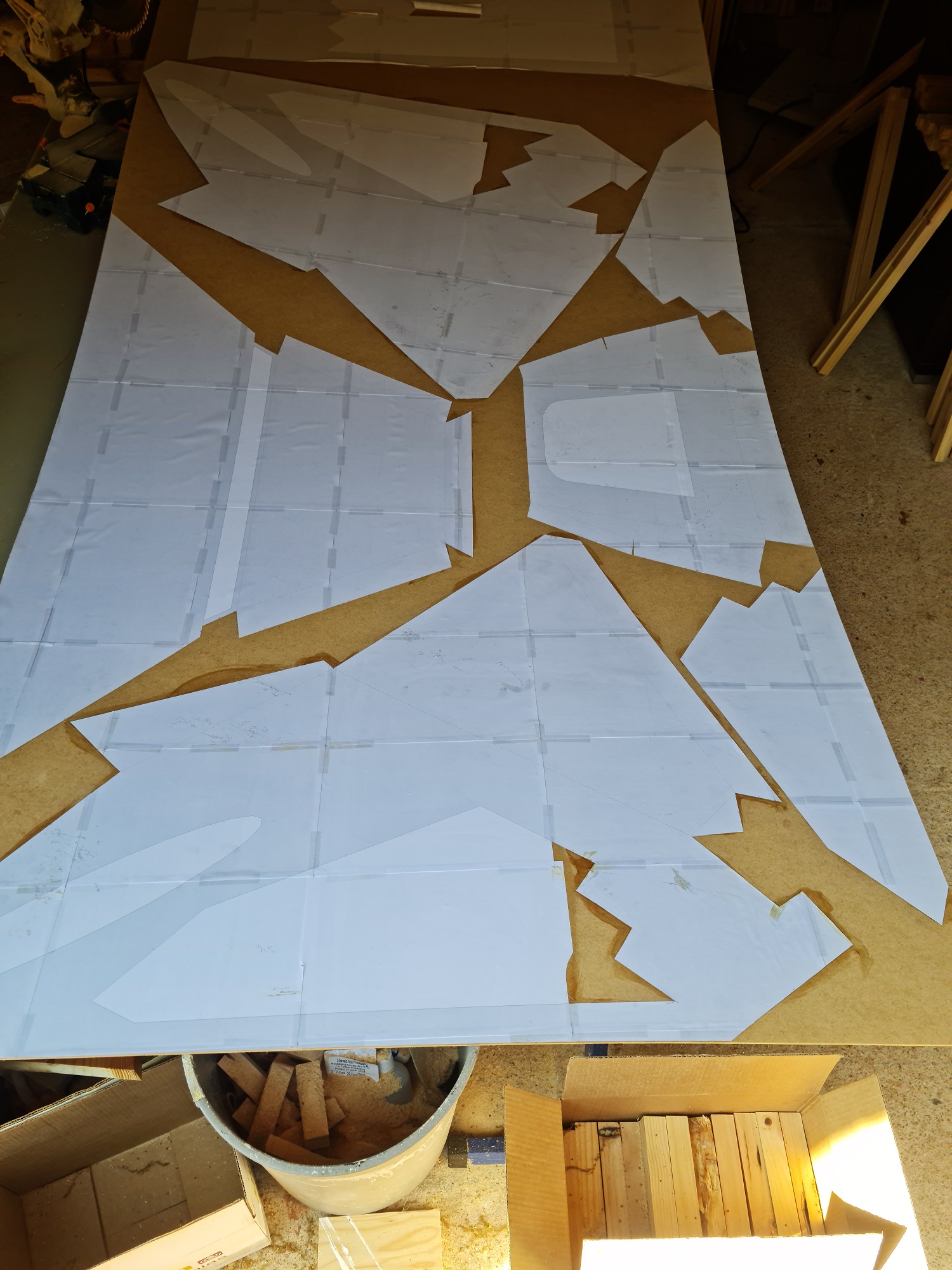

And then gluing them down onto the boards...

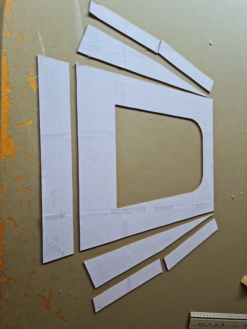

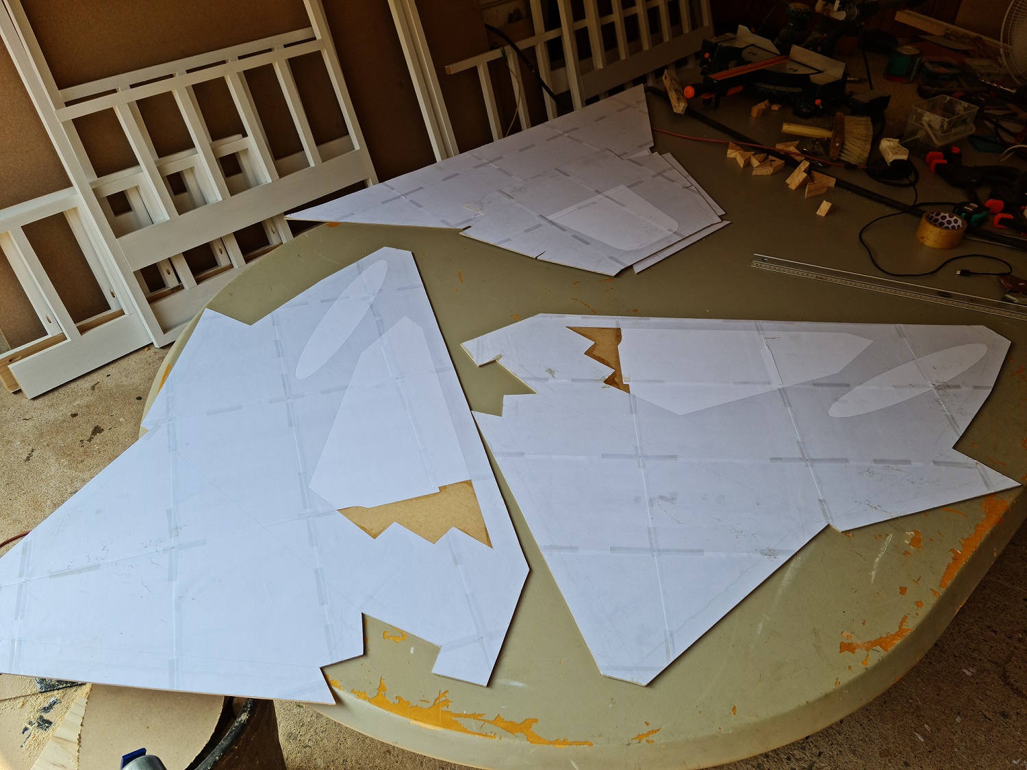

And started cutting the out...

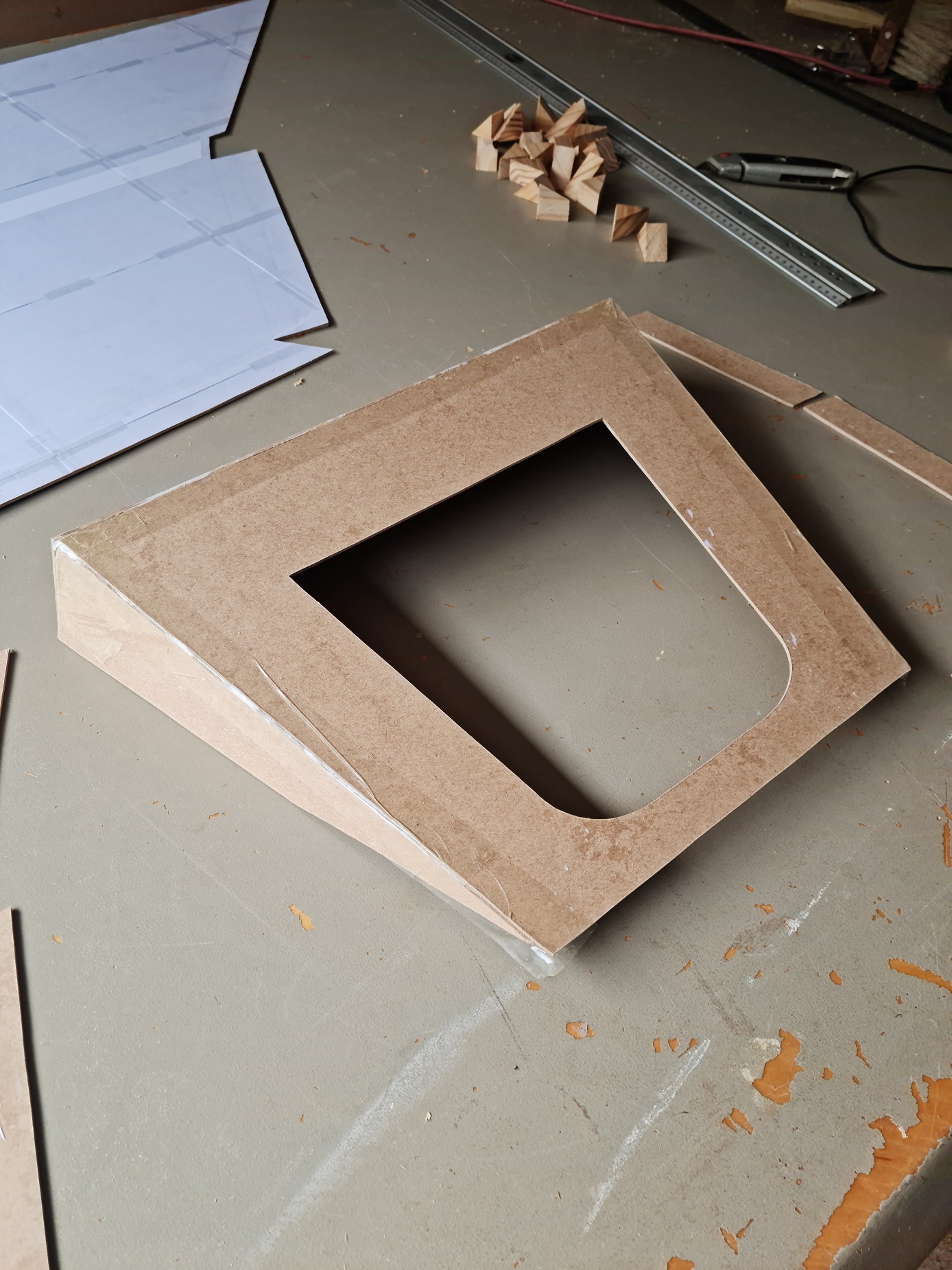

After cutting the last of the pieces I deiced to get started with mocking up the bottom section with 2" tape and glue to keep it together without having to clamp it down...

Nice. How do you cut the wood? Jigsaw?
Re: ** WAR's "Black Tank" Tumbler Build **
slysnake wrote: Thu Oct 03, 2024 1:08 pm Nice. How do you cut the wood? Jigsaw?
Hi Sly,
Yeah this is 3mm hardboard so with all the small pieces I just use a jigsaw and cut about 1mm outside the lines and then I smooth all the pieces down on the big sander to make sure They are nice and straight.
And then when I do the mock up of the pieces, I can then see if I need to do any adjustments on the pieces like maybe a slight angle or something to get a nice smooth join and alignment...
