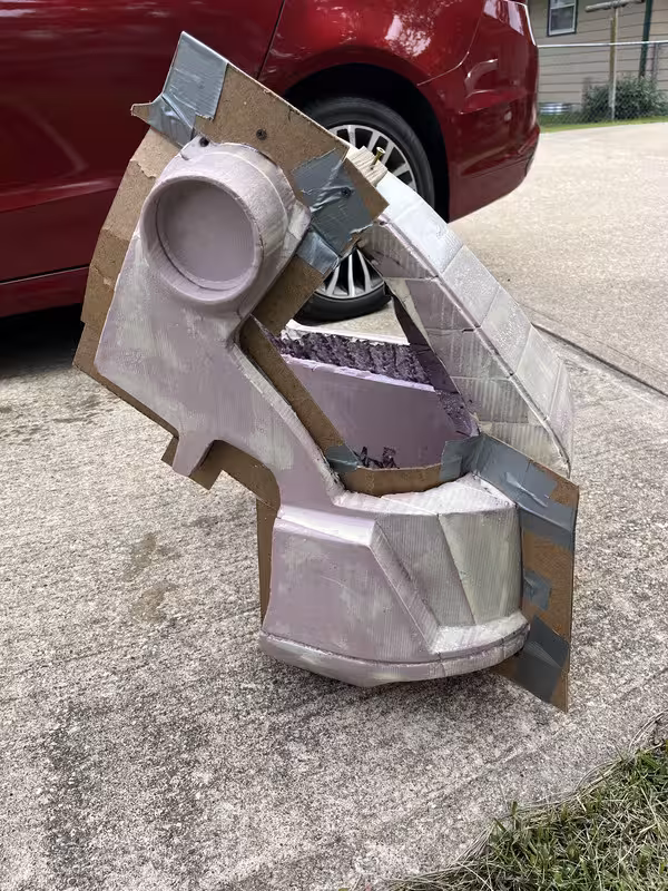

I've been working on the front wheel covers. These have turned out to be the most difficult molds to make so far. Smaller size than the other molds but lots of tricky curves that made it harder to place mold flanges.

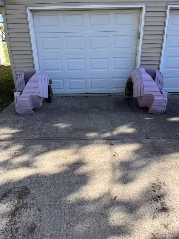

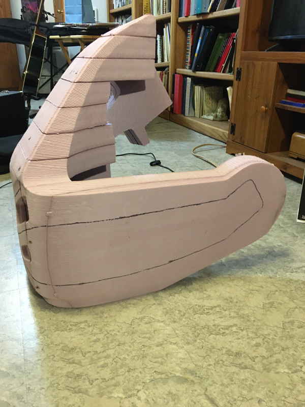

Here's some pictures of one of the plug molds before any prep work
And here's a pic of part of a flange being installed

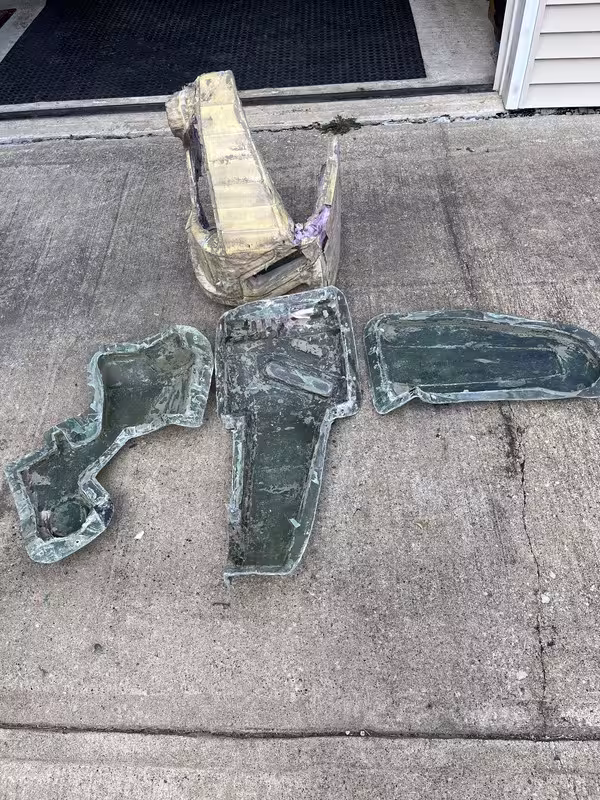

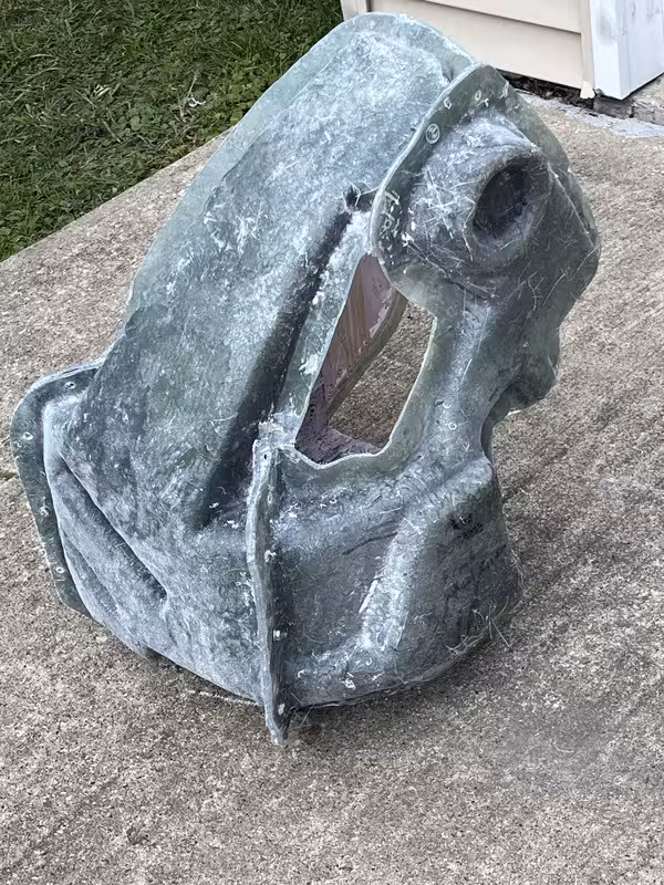

Here's the finished molds
And the mold after separation from the plug

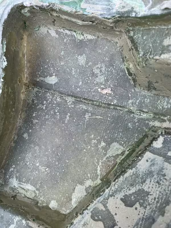

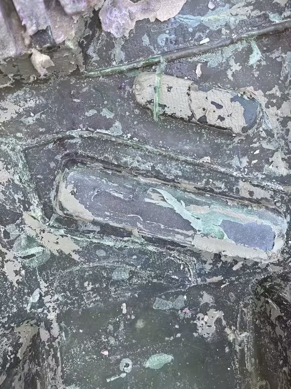

I used a different material for the lines this time. It's like a talcum powder material the fiberglass supplier recommended. It was a lot easier to get nice lines. We'll see how strong it is. But the lines turned out great. Tried to get some close ups of the lines here

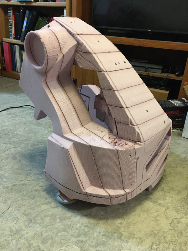

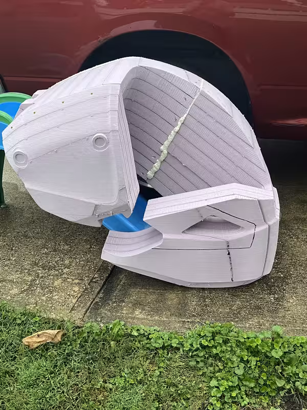

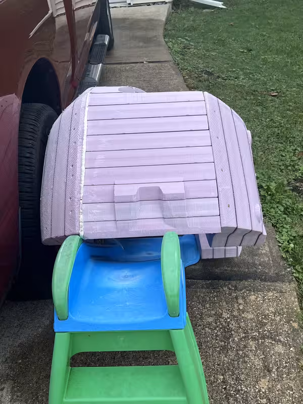

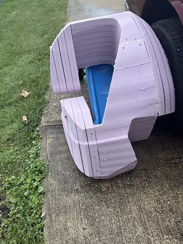

Just a small update. Finished milling and assembling the Passenger Side Rear Wheel cover plug mold. It still needs to be processed (sanded, filled, sanded again, coated with sealant) before I can put on the flanges and then actually apply the fiberglass to make a mold. Starting to mill the other side soon.
This is what it looks like on the car

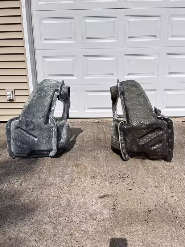

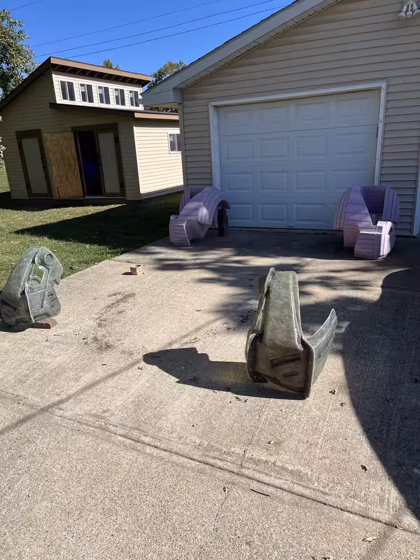

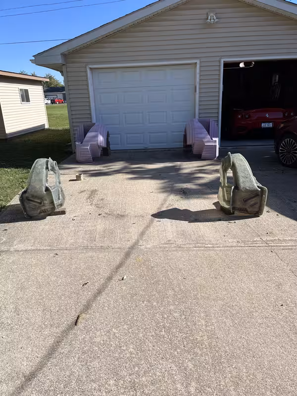

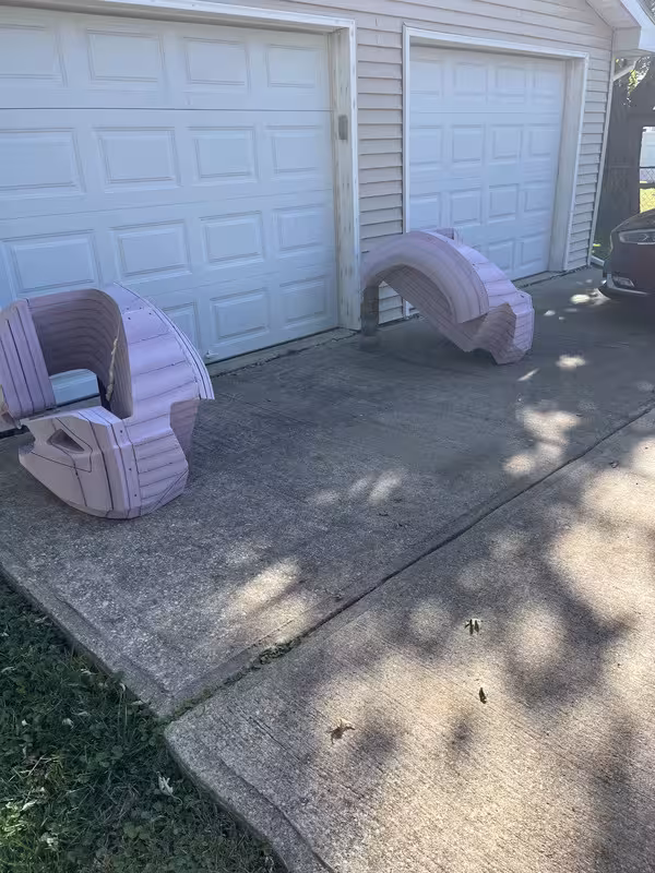

Finished milling the passenger side rear wheel cover.
And here is both covers spaced approximately the correct distance apart.
Added the front wheel covers (molds) To get an approximate look at the size of the car. (Very approximate. Just guessing really)
